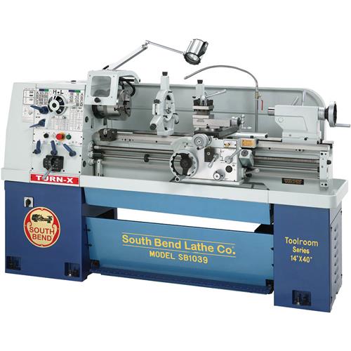

This South Bend lathe is supplied with an adjustable feed rod clutch & stop collar on the feed rod. This is a great safety feature when working close to the chuck. Set the stop collar so the saddle & tool post are positioned at a safe distance from the chuck & tighten the lock screw. Adjust the feed rod clutch to a low setting. If the carriage comes into contact with the collar, the clutch slips, saving your machine from a serious crash.
  • Swing over bed: 14.17"
  • Distance between centers: 40"
  • Swing over cross slide: 8.66"
  • Swing over gap: 20.94"
  • Width of bed: 9"
  • Spindle nose to gap: 6.46"
  • Cross slide travel: 7"
  • Compound slide travel: 4"
  • Spindle nose: D1-5 camlock
  • Spindle bore: 1.57"
  • Spindle taper: MT #5
  • Spindle speeds: (16) from 50 - 2570 RPM
  • Tailstock taper: MT #3
  • Tailstock travel: 4.5"
  • Tailstock barrel diameter: 1.968"
  • Inch thread range: 2 to 72 tpi (45 pitches)
  • Metric thread range: 0.2 to 14 mm (39 pitches)
  • Modular threads: 0.3 to 3.5 (18 pitches)
  • Diametral threads: 8 to 44 (21 pitches)
  • Longitudinal feed range: 0.002 to 0.067 IPR
  • Cross feed range: 0.001 to 0.034 IPR
  • Number of feed selections: 45
  • Coolant motor size: 1/8 HP
  • Spindle motor size: 5 HP/2.5 HP
  • Voltage: 220V, 3-phase, 60 cycle
  • Machine footprint: 80-3/4" x 19-1/2"
  • Approximate shipping weight: 2484 lbs
    Standard Equipment:
  • Allen Bradley electrical components
  • Meehanite casting, signature South Bend 3 V-bed
  • 8" 3 jaw scroll chuck w/ D1-5 plate
  • 10" 4 jaw ind. chuck D1-5
  • 12" faceplate D1-5
  • Safety chuck guard with microswitch shut-off
  • Steady rest with roller tips
  • Follow rest
  • 4-way tool post
  • Halogen lamp
  • Complete coolant system
  • Micrometer carriage stop
  • Spindle sleeve MT#5/MT#3
  • Two MT#3 Dead centers
  • Threading dial indicator
  • Leveling pads - 6 pcs.
  • NTN Japanese spindle bearings
  • Full length splash guard
  • Front removable sliding chip tray
  • Tool set & box
  • Operation manual & parts list
