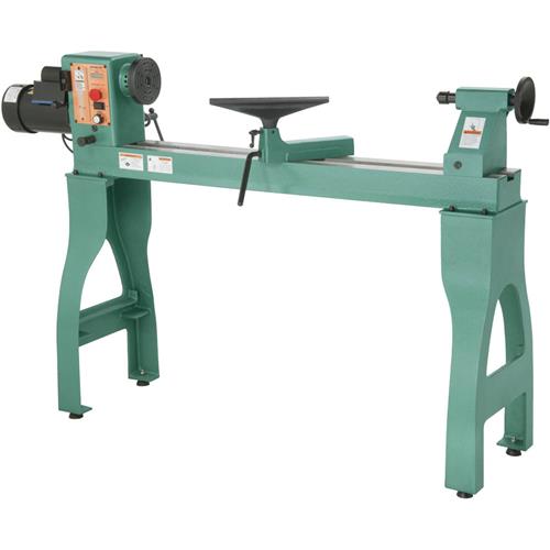

Aside from its large turning capacities, this machine has all of the features you would hope for in a Heavy-Duty Wood Lathe. For example, electronic variable speed in two speed ranges, digital speed readout, a swiveling headstock for outboard turning, indexable spindle, spindle lock pin and a forward and reverse switch for outboard bowl turning are just some of the standard features you can expect. The bed is precision-ground steel for strength and durability, and the heavy cast-iron legs can be easily adapted for adding more mass. Best of all, this lathe runs on single-phase power, so it can be used in home shops as well as the workplace. The variable-frequency drive runs the 3-phase motor to provide variable-speed control and maximum torque at low speeds. If you're looking for a lathe that will handle all of your turning needs, this is the one!
Standard Equipment:
  • Spur center
  • Cup live center
  • Knockout tool
  • Indexing pin
  • Tool rest
  • 6" face plate
  • Hex wrenches
    Features:
  • Electronic variable-speed control
  • Digital spindle-speed indicator
  • 30° direct indexing using 1 indexing hole
  • 10° indexing using all 3 indexing holes
  • Headstock can be positioned anywhere along the bed
  • Tailstock, headstock and tool rest support have lever action cam locks for quick positioning
  • Belt drive offers 2 speed ranges to maximize spindle torque
  • Spindle lock pin
  • Outboard spindle handle
  • Forward/reversing switch
  • Emergency stop switch
  • Motor: 1-1/2 HP, 220V, 3-phase with single-phase VFD
  • Power requirement: 220V, single-phase
  • Swing over bed: 16"
  • Swing over tool rest base: 11-1/2"
  • Distance between centers: 42"
  • Heavy-duty, precision machined steel bed and cast-iron legs ensures stability and minimize vibration
  • 1-1/4" x 8 TPI RH headstock spindle
  • Variable-speed spindle control with digital readout
  • Speed range, high: 250-3200 RPM low: 100-1200 RPM
  • MT#2 spindle & tailstock tapers
  • Spindle bore: .445"
  • Tool post diameter: 25mm
  • Overall dimensions: 77-1/16"L x 22-1/16"W x 47"H
  • Approximate shipping weight: 394 lbs.
