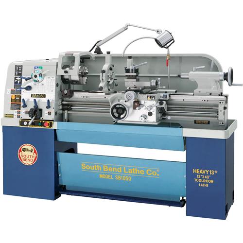

Built in the South Bend tradition for speed, accuracy, and absolute high quality, the Heavy 13® lathes feature easy-to-use spindle speed controls, conveniently-located control panel, flood coolant system, micrometer stop, feed clutch rod, safety foot brake, safety chuck guard with shut-off microswitch, and a fully-enclosed quick-change gearbox. Also featured on these precision lathes are Japanese spindle bearings, Allen-Bradley® controls, precision hardened and ground gears, and the signature South Bend three V-way bed made with Meehanite® castings. Includes chucks and other accessories to quickly get you up and running.
  • Swing over bed: 13.38"
  • Distance between centers: 40"
  • Swing over cross slide: 8.26"
  • Swing over gap: 20"
  • Swing over saddle: 11.02"
  • Cross slide travel: 7"
  • Compound travel: 4"
  • Spindle nose: D1-5
  • Spindle bore: 1.57"
  • Spindle taper: MT #5
  • Spindle speeds: (8), 80-2000 RPM
  • Tailstock taper: MT #3
  • Tailstock travel: 4.5"
  • Tailstock barrel diameter: 1.968"
  • Inch threads: (45) 2 to 72 TPI
  • Metric threads: (39) 0.2 to 14 mm
  • Modular pitches: (18) 0.3 to 3.5 MP
  • Diametral pitches: (21) 8 to 44 DP
  • Number of longitudinal feeds: 17
  • Longitudinal feed range: 0.002" to 0.067"
  • Number of cross feeds: 17
  • Cross feed range: 0.001" to 0.034"
  • Spindle motor: 3 HP, TEFC induction
  • Voltage/Amps: 220V, single-phase, 19.45A
  • Coolant motor: 1/8 HP, TEFC induction
  • Approximate shipping weight: 2582 lbs.
    Standard Equipment:
  • 7" 3-Jaw Scroll Chuck (Bolt on Jaws)
  • 8" D1-5 4-Jaw Independent Chuck
  • Chuck Safety Guard with Limit Switch
  • Faceplate 10" D1-5
  • Steady Rest
  • Follow Rest
  • Halogen Work Light
  • Coolant System
  • Dead Center MT #3, 2 pcs
  • Spindle Center Sleeve MT #5 - MT #3
  • Micrometer Carriage Stop
  • 4-Way Tool Post
  • Tool Set & Box
  • Level Pads 6 pcs.
    Features:
  • Three V-way Bed
  • Japanese Spindle Bearings
  • Full Length Splash Guard
  • Operation Manual
  • Allen Bradley Controls
  • Handwheel Safety Guard
  • Sliding Chip Tray
  • Rounded Corner Back Splash
  • Wood Crate
