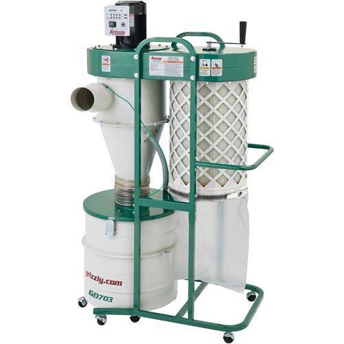

    Finally, a two-stage Cyclone Dust Collector with all the features the larger cyclones, but in a compact size that fits under a standard 8' ceiling. Aside from the cleaner operation of a two-stage system, this Cyclone features a pleated filter system with internal shaker paddles for maintaining filter efficiency, remote control switch for activating the Cyclone from across the room, roll-away collection drum for easy dumping, and a 6" inlet for handling larger duct systems. If you’ve always dreamed of having a Cyclone Dust Collector, but didn’t have the space, this is the one for you!
  • Remote control switch
  • Cartridge filter has crank handle shaker for maximum filter efficiency
  • Easy cleaning drum canister rolls on swivel casters
  • Fully mobile with built-in casters
  • Unique vacuum equalizer built into collection drum for use with disposable plastic bags.
  • Motor: 1-1/2 HP, 110V/220V, single-phase, TEFC, 3450 RPM, prewired 110V
  • Air suction capacity: 775 CFM
  • Static pressure at rated CFM: 1.80"
  • Intake port: 6" with included 5" optional port
  • Impeller: 13-1/2"
  • Cartridge filter surface area: 48 square feet
  • Sound rating: 83 dB
  • Overall dimensions: 38-1/4" W x 23-1/4" D x 68" H
  • Approx. shipping weight: 210 lbs.
