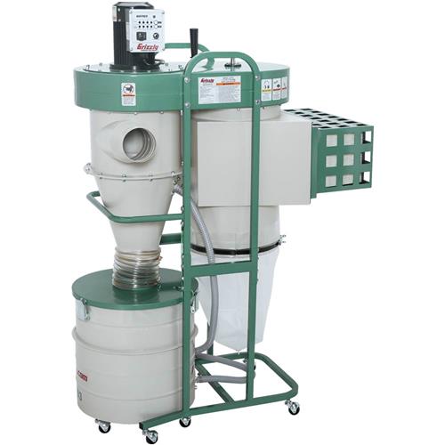

The same unit as our G0703, but pre-equipped with the upgraded dual-filtration HEPA filter system! Features a primary filter efficiency of 99.9% at 0.2-2 microns, and a secondary HEPA filter efficiency of 99.97% at 0.3 microns in size.
Finally, a two-stage Cyclone Dust Collector with all the features the larger cyclones, but in a compact size that fits under a standard 8' ceiling. Aside from the cleaner operation of a two-stage system, this Cyclone features a pleated filter system with internal shaker paddles for maintaining filter efficiency, remote control switch for activating the Cyclone from across the room, roll-away collection drum for easy dumping, and a 6" inlet for handling larger duct systems. If you've always dreamed of having a Cyclone Dust Collector, but didn't have the space, this is the one for you!
Features:
  • Remote control switch
  • Included remote control magnetic switch
  • Easy cleaning drum canister rolls on swivel casters
  • Fully mobile with built-in casters
  • Unique vacuum equalizer built into collection drum for use with disposable plastic bags.
  • Motor: 1-1/2 HP, 110V/220V, single-phase, TEFC, 3450 RPM, prewired 110V
  • Airflow capacity: 775 CFM
  • Static pressure at rated CFM: 1.80"
  • Intake port: 6" with included 5" optional port
  • Impeller: 13-1/2"
  • Sound rating: 78–80 dB
  • Cartridge filter surface area: 48 square feet
  • Overall dimensions: 38-1/4" W x 23-1/4" D x 68" H
  • Approx. shipping weight: 288 lbs.
    220V Operation: 220V operation requires installation of a 220V conversion kit. For your own safety, all wiring procedures MUST be completed by an electrician or other qualified service personnel. See Owner’s Manual for details.
