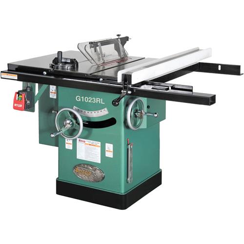

It took nearly two years of refinement & design optimization to improve our best-selling "G1023S" series table saws. The result is our new line of "G1023R" series table saws, featuring all the best from the old models plus a new riving knife system, serpentine-belt power transfer that runs quieter & smoother, encapsulated dust collection around the underside of the blade, & an improved quick-release blade guard. CSA certified meeting CSA C22.2 #71.2-08 and UL 987-7th standards!
Features:
  • Motor: 3HP, 240V, single-phase, 14A, 3450 RPM
  • Solid cast iron table is first heat treated for strength then milled perfectly flat & ground to a mirror-like finish
  • Table size (with 2 solid extension wings attached) is 40" x 27"
  • Table has T-slots so your miter gauge will not fall off the table when retracted
  • 5/8" diameter arbor is long enough to accept dado blades up to 13/16"
  • Extra large handwheels really ease arbor movement
  • Quick change between riving knife & splitter guard
  • Cutting capacity: 8" left, 26" right of blade
  • Maximum depth of cut @ 90° 3"
  • Maximum depth of cut @ 45° 2-1/8"
  • 4" dust port included
  • Magnetic safety switch is standard
  • One piece steel cabinet type stand
  • All sealed ball bearing construction
  • Poly-V serpentine belt system transfers power more efficiently & with less noise than standard V-belts
  • Powder coated paint
  • Footprint: 20-1/2" x 20-1/2"
  • Approximate shipping weight: 508 lbs.
  • Includes 10" x 40T blade!
Show More...
