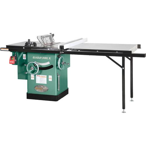

    This is the one you've been waiting for! Featuring 53" of rip capacity, a quick-release bade guard, interchangeable riving knife, encapsulated-blade dust extraction, and a highly efficient serpentine belt/pulley system that runs much quieter and smoother than its predecessor. This left-tilting table saw includes the tremendously popular Shop Fox® Classic fence and heavy-duty extension table. Best of all, everything is included for one low price, making this one of the greatest package deals available anywhere. CSA certified meeting CSA C22.2 #71.2-08 and UL 987 standards!
    Features:
  • Motor: 3 HP, 240V, single-phase, 14A, 3450 RPM
  • Solid cast iron table is first heat treated for strength then milled perfectly flat and ground to a mirror-like finish
  • Extension table: 44" x 27"
  • Table has T-slots so your miter gauge will not fall off the table when retracted
  • 5/8" diameter arbor is long enough to accept dado blades up to 13/16"
  • Extra large handwheels are the heaviest in the industry and really ease arbor movement
  • One piece steel cabinet type stand
  • Quick change between riving knife and splitter guard
  • Cutting capacity: 8" left and 53" right of blade
  • Maximum depth of cut @ 90°: 3"
  • Maximum depth of cut @ 45°: 2-1/8"
  • 7' rails
  • All sealed ball-bearing construction
  • Poly-V serpentine belt system transfers power more efficiently and with less noise than standard V-belts
  • Dust port: 4"
  • Magnetic safety switch
  • Powder coated paint
  • Footprint: 20-1/2" x 20-1/2"
  • Approximate shipping weight: 550 lbs.
  • Includes 10" x 40T blade!
