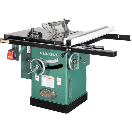

G1023RL 10" 3 HP 240V Cabinet Table Saw
This professional-grade table saw will be the centerpiece of your shop.
Recognized as the Best Value by Fine Woodworking Magazine. Product testers Fine Woodworking agree; the G1023RL is the best value in full-size cabinet saws!
The G1023RL 10" 240V Cabinet Table Saw has been improved, refined, and optimized into this finished product.
The powerful 3 HP motor rotates the arbor at 4200 RPM. This equates to the 10" x 40T having a rim speed of 11,000 FPM and is ready to rip and cut all day long.
A poly-V serpentine belt system transfers power more efficiently and with less noise than standard V-belts.
The precision-ground, cast-iron table has T-slots so your miter gauge will not fall off the table when retracted.
CSA certified
  • Motor: 3 HP, 240V, single-phase, 14A
  • Rip capacity: 32" right, 14" left of blade
  • Maximum depth of cut @ 90°: 3"
  • Maximum depth of cut @ 45°: 2-1/8"
  • Overall table dimensions: 40" W x 27" D
  • Distance from front of table to center of blade: 17"
  • Floor-to-table height: 34"
  • Arbor diameter: 5/8"
  • Arbor speed: 4200 RPM
  • Maximum width of dado: 13/16"
  • Footprint: 20-1/2" x 20-1/2"
  • Overall dimensions: 66" W x 47" D x 39-3/4" H
  • Approximate shipping weight: 508 lbs.
  • Solid cast-iron table is heat-treated for strength, milled perfectly flat and ground to a mirror-like finish
  • Extra-large handwheels ease arbor movement
  • Locking magnetic switch includes padlock and key to prevent unauthorized use
  • Accepts dado blades up to 13/16" with 5/8" diameter arbor
  • Large safety STOP paddle
  • One-piece steel cabinet type stand
  • Quick changing between riving knife and splitter guard
  • 4" dust port
