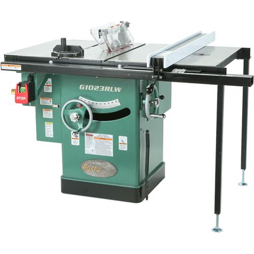

G1023RLW 10" 3 HP Cabinet Table Saw w/ Built-in Router Table
Everything you need in a high-end table saw!
We took our G1023RL Cabinet Table Saw and made it even better by including a built-in router table that doubles as a table extension wing. The G1023RLW 10" 3 HP 240V Cabinet Table Saw with Built-in Router Table includes support legs and universal T-track router clamping system. The Shop Fox® Classic Fence included for the table saw doubles as a router table fence.
You'll find that using this system is actually much nicer and more convenient than using a typical router table or hand held router for those cuts where the fence is not required to be offset, especially if the table saw is set up with large outfeed tables. Another great advantage is being able to make laser straight dadoes without having to change table saw blades. Please note: this router table does not work with small trim routers.
