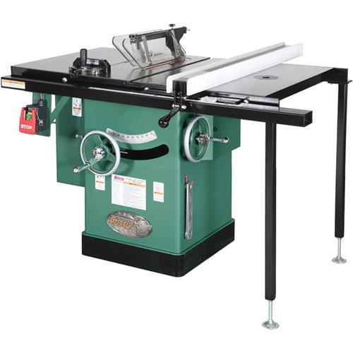

G1023RLWX 10" 5 HP Cabinet Table Saw Built-in Router Table
A high-performance 10-inch cabinet table saw.
We took the platform of the Grizzly G1023RL and made it even better by upgrading to a 5 HP motor and including a built-in router table that doubles as a table extension wing. The G1023RLWX 10" 5 HP 240V Cabinet Table Saw with Built-in Router Table includes support legs, universal T-track router clamping system, and the Shop Fox® Classic Fence.
You'll find that using this system is actually more convenient than using a typical router table or hand held router for those cuts where the fence is not required to be offset, especially if the table saw is set up with large outfeed tables. Another great advantage is being able to make laser straight dadoes without having to change table saw blades. Please note: this router table does not work with small trim routers.
