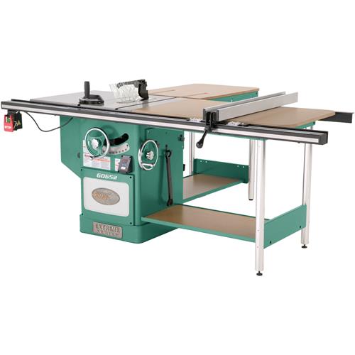

    Cut panels & wide stock all day long with this 10" Heavy-duty Cabinet Table Saw. A 52" rip capacity & extended side & rear tables will support a full sheet of plywood, making ripping & cross cutting operations safe & simple. A guard with splitter or interchangeable riving knife helps prevent binding and kickback, and a rail mounted magnetic switch with thermal overload protection provides additional safety features. Bevel cutting is also safe & precise with the left tilting blade & digital angle display. Includes a miter gauge & 10" blade. CSA certified meeting CSA C22.2 #71.2-08; CSA C22.2 #105-1953 and UL 987 standards!
  • 5 HP, 220V/440V*, 3-phase
  • 12/6 Amps
  • Blade tilt: Left, 45°
  • Table height from floor: 34-7/8"
  • Table size with extension: 27" x 75-3/4"
  • Arbor speed: 4000 RPM
  • Arbor size: 5/8"
  • Maximum dado width: 3/4"
  • Maximum depth of cut @ 90°: 3-3/16"
  • Maximum depth of cut @ 45°: 2-3/16"
  • Maximum rip capacity: 52" right, 18" left
  • Distance from front of table to blade at maximum cut: 10-5/16"
  • Distance from front of table to center of blade: 14-7/8"
  • Overall dimensions: 91-1/2"L x 75"W x 40-5/8"H
  • Approximate shipping weight: 716 lbs.
    Features:
  • Cast-iron trunnions
  • 3/8" x 3/4" T-slots & miter gauge
  • 4" dust port
  • Power transfer: Serpentine belt
  • Steel cabinet
  • Hinged motor cover
  • Right hand and rear extension tables
  • Quick release steel splitter
  • Digital readout for bevel angle
  • Includes 10" x 40T blade
    440V operation requires purchasing additional components and installation by our technicians. Please call customer service at (570) 546-9663 for more information
    D3122 PUSH STICK INCLUDED
