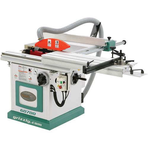

Get all the features of a true sliding table saw, but in a footprint that’s sized for smaller shops. You’ll love the effortless sliding table for cross cutting, the reversespinning scoring blade that eliminates tear-out, the riving knife and blade guard with dust hose for added safety, and the miter gauge with adjustable flip-stop for repeat angle cutting. For standard ripping operations, just lock the sliding table in place and use the traditional rip fence. The extruded-aluminum rip fence is guided by a heavy cast iron frame and can be installed on its side when guiding thin stock. Why settle for a standard table saw when this one does it all? CSA certified meeting CSA C22.2 #105-1953 standards!
  • Adjustable scoring blade ensures tear-out free cuts
  • Durable extruded-aluminum sliding table
  • Miter fence can be positioned at 45° right and left
  • Miter fence has flip-stop for repetitive cutting
  • Precision-ground cast iron main table
  • Quick clamp on sliding table
  • Main blade and scoring blade sold separately
  • Includes riving knife
  • Adjustable scoring blade kerf
  • Single lever locking fence
  • Fence rotates 90° for guiding thin stock
  • 4" main dust port and 2-1/2" blade guard dust port
  • Underside of blade encapsulated in dust shroud for optimum dust extraction
  • Motor: 5 HP, 230V, single-phase, 19A
  • Main blade size: 10"
  • Main blade arbor: 5/8"
  • Main blade tilt: 0-45°
  • Main blade arbor speed: 4000 RPM
  • Depth of cut at 90°: 3-1/8"
  • Depth of cut at 45°: 2-1/4"
  • Scoring blade size: 3-1/8" (80mm)
  • Scoring blade arbor: 22mm
  • Scoring blade arbor speed: 8000 RPM
  • Scoring blade tilt: 0-45°
  • Sliding table size: 12-1/4" x 39-3/8"
  • Maximum rip capacity: 34"
  • Maximum sheet capacity without scoring blade: 39-3/8" x 27-1/2"
  • Maximum sheet capacity with scoring blade: 34" x 27-1/2"
  • Maximum dado width: 13/16"
  • Length of cross cut: 27-1/2"
  • Main table dimensions: 14-3/4" x 27"
  • Approximate shipping weight: 584 lbs
