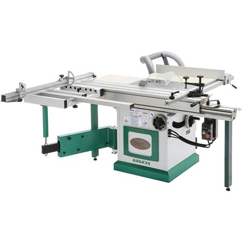

Description
Get all of the benefits of a Sliding Table Saw in a size that will fit any shop. Large size panels are fully supported by the sliding table, making ripping and cross cutting almost effortless. The scoring blade eliminates tear-out, for factory fresh edges every time and dust control is handled by the 4" main port and 2-1/2" port on the blade guard. Easy to set up and operate, this 10" Sliding Table Saw belongs in every production shop.
  • Motor: 5 HP, 230V, single-phase
  • Main blade size: 10"
  • Main blade arbor: 5/8"
  • Main blade tilt: 0-45°
  • Main blade arbor speed: 4,000 RPM
  • Depth of cut at 90°: 3-1/8"
  • Depth of cut at 45°: 2-1/4"
  • Scoring blade size: 3-1/8" (80mm)
  • Scoring blade arbor: 22mm
  • Scoring blade tilt: 0-45°
  • Sliding table size: 12-1/4" x 63"
  • Maximum rip capacity: 33"
  • Length of cross cut: 78-1/2"
  • Main table dimensions: 14-3/8" x 27"
  • Approximate shipping weight: 688 lbs.
  • Scoring blade ensures tear-out free cuts
  • Durable extruded aluminum sliding table
  • Miter fence can be positioned at 45° right and left
  • Miter fence has two swing stops for repetitive cutting
  • Table extension on right and rear side of main table permits convenient cutting of large panels
  • Precision ground cast iron main table
  • Quick clamp on sliding table
  • Main blade sold separately
  • Adjustable riving knife
  • Adjustable scoring blade kerf
  • Single lever locking fence
  • 4" main dust port and 2-1/2" blade guard dust port
