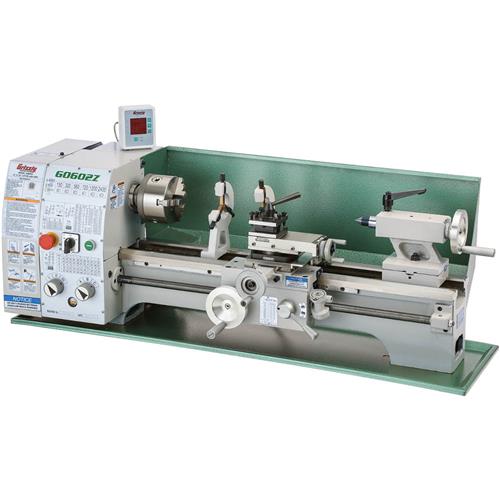

Our 10" x 22" Benchtop Metal Lathe sports generous capacity, a lot of thread ranges, a wider bed, and a larger chuck, yet it costs only a little more than our G4000. With features like a 1" spindle bore, 3/4"–12 TPI leadscrew and an MT#3 tailstock, you'll be able to turn some surprisingly hefty projects! If you're thinking of making parts for models, engines or even for repairs around the home or shop, take a good look at this lathe and the specs below.
  • Swing over bed: 9-1/2"
  • Swing over cross slide: 6-1/8"
  • Distance between centers: 22"
  • Spindle bore: 1" (25mm)
  • Spindle thread: 1-3/4" x 8 TPI
  • Spindle taper: MT#4
  • Motor: 1 HP, 110V, single-phase, 13.6A
  • Spindle speeds: 150, 300, 560, 720, 1200, 2400 RPM
  • Leadscrew: 3/4"–12 TPI
  • Compound travel: 3-1/2"
  • Cross slide travel: 6-1/2"
  • Carriage travel: 18-1/2"
  • Maximum tool size: 1/2"
  • Tailstock quill travel: 2-1/2"
  • Tailstock taper: MT#3
  • Number of longitudinal feeds: 9
  • Range of longitudinal feeds: 0.0025–0.0140 IPR
  • Number of inch threads: 33
  • Range of inch threads: 8–72 TPI (RH)
  • Number of metric threads 26
  • Range of metric threads: 0.25–3.50mm (RH only)
Standard Equipment:
  • • 5" 3-Jaw chuck with two sets of jaws • 6-1/2" 4-Jaw chuck with reversible jaws
  • 8" Faceplate
  • 4-Way tool post
  • Steady rest with 1/4"–2" capacity
  • Follow rest with 1/4"–2" capacity
  • MT#3 dead center
  • Oil-bath gearbox
  • Chip tray and backsplash
  • Toolbox with service tools
