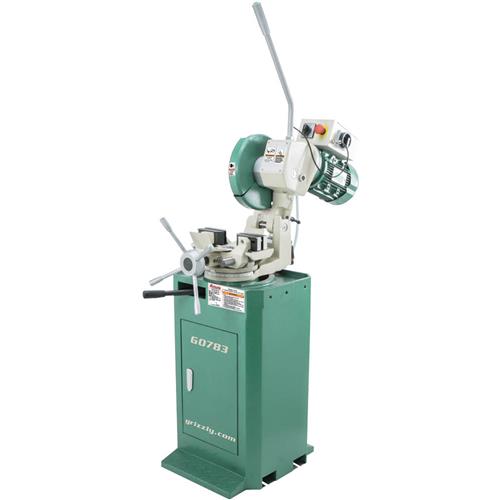

This machine's mighty 2.7 HP, 220V, 3-phase motor and gear drive produce a blade speed of either 114 RPM or downright slow 57 RPM. Dual-vise system clamps on each side of the blade and coolant system prevents the blade from overheating. A perfect choice for clean, precise, spark-free metal cutting! Blade not included, see T27132.
  • Motor: 2.7 HP/1.9 HP, 220V, 3-phase, 9.1A/6.3A, 2-speed
  • Power transfer: Gear drive
  • No-load blade speeds: 57 or 114 RPM
  • Blade diameter: 275mm (11")
  • Blade arbor diameter: 40mm
  • Vise jaw depth: 4-1/2"
  • Vise jaw height: 2"
  • Head swivel: 90° left or right
  • Max capacity round @ 45 degrees & 90 degrees: 2-3/8"
  • Max capacity square @ 90 degrees: 2-3/8" x 2-3/8"
  • Max capacity square @ 45 degrees: 2-3/8" x 2-3/8"
  • Max capacity rectangular @ 90 degrees: 2-3/4" x 2-3/8"
  • Max capacity rectangular @ 45 degrees: 4" x 2-3/8"
  • Approximate shipping weight: 441 lbs.
