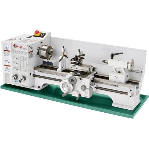

This is another great starter metal lathe with more capacity than typical benchtop lathes! This specially designed machine is an outstanding value and able to take on light duty jobs requiring a 10-5/8" swing, a 1" spindle bore and 26" between centers. And with a 1 HP motor, you’ll be able to make quick work of even the most challenging jobs. This is an awesome value and a lot of lathe for a hobby machinist! Feeds and threads to the left only.
Standard Equipment:
5" 3-jaw chuck with two sets of jaws6-1/2" 4-jaw chuck with reversible jawsSteady restFollow restMT #3 & MT #4 Dead centers4-way tool postFaceplateTool box & tool kitChange gearsSpecifications:
Swing over bed: 10-5/8"Swing over cross slide: 6-3/8"Distance between centers: 26"Spindle bore: 1"Spindle nose taper: MT #4Motor: 1 HP, 110V, single-phaseNumber of speeds: 6Range of speeds: 150, 300, 560, 720, 1200, 2400 RPMLead screw: 3/4" x 8 TPICompound travel: 3-1/2"Cross slide travel: 7"Carriage travel: 23"Maximum tool size: 1/2" x 1/2"Tailstock barrel travel: 1-1/8"Tailstock barrel taper: MT #3Spindle thread: 1-3/4" x 8 TPINumber of longitudinal feeds: 12Range of longitudinal feeds: 0.0022–0.0150 IPRNumber of inch threads: 24 Range of inch threads: 8–56 TPINumber of metric threads: 10Range of metric threads: 0.5–3.0mmOverall dimensions: 23" W x 51" L x 19" HApproximate shipping weight: 559 lbs.Comes with chip tray and splash guard!
