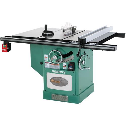

If you like the G0605X and G0606X shown on the next page, but don’t have the space or need the long rails and extension tables, we’ve created these saws with you in mind. You still get the same great features like beefy cast iron table, wings, handwheels and trunnions, 4" depth of cut, digital bevel cutting readout, left tilting saw blade and metal guard with full time riving knife, but without the extended rip capacity. So, if you’ve ever wished for the extra cutting height of a 12" table saw, but don’t have the space or need for long rails, these are the table saws for you!
  • Motor: 5 HP, 220V, single-phase or 71/2 HP, 220V/440V*, 3-phase
  • Amps: 25 Amps(G0696X), 20/10 Amps (G0697X)
  • Blade tilt: Left
  • Table height from floor: 35-3/4"
  • Table size with wings: 30-3/4" x 48-3/8"
  • Arbor speed: 3600 RPM
  • Arbor size: 5/8" & 1"
  • Maximum dado width: 3/4"
  • Maximum depth of cut @ 90°: 4"
  • Maximum depth of cut @ 45°: 2-3/4"
  • Maximum rip capacity: 36"
  • Distance from front of table to blade at maximum cut: 13-1/2"
  • Distance from front of table to center of blade: 17-1/4"
  • Overall dimensions: 75"W x 44"D x 42-1/2"H
  • Approximate shipping weight: 756 lbs.
  • Precision ground cast iron table
  • Cast iron trunnions
  • 3/8" x 3/4" T-slots & miter gauge
  • 4" dust port
  • Power transfer: V-belt
  • Steel cabinet
  • Hinged motor cover
  • Digital readout for bevel angle
  • Includes 12" blade and riving knife
