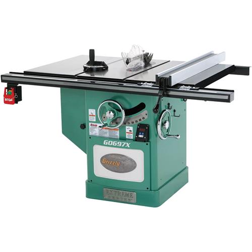

    If you like the G0605X and G0606X, but don’t have the space or need the long rails and extension tables, take a look at this model. You get the same great features, including a beefy cast-iron table, extension wings, cast-iron hand wheels and trunnions, 4" depth-of-cut, digital bevel cutting readout, left-tilting saw blade with metal guard and full-time riving knife, all in a compact package. So, if you’ve ever wished for the extra cutting height of a 12" table saw, but don’t have the space or need for long rails, these are the table saws for you! CSA certified meeting CSA C22.2 #71.2-08; CSA C22.2 #105-1953 and UL 987 standards!
    • Motor: 7.5 HP, 220V/440V*, 3-phase
    • Amps: 19.5A/10A
    • Blade tilt: Left
    • Table height from floor: 35-3/4"
    • Table size with wings: 30-3/4" x 48-1/4"
    • Arbor speed: 3600 RPM
    • Arbor size: 1"
    • Maximum dado width: 3/4"
    • Maximum depth of cut @ 90°: 4"
    • Maximum depth of cut @ 45°: 2-3/4"
    • Maximum rip capacity: 36"
    • Distance from front of table to blade at maximum blade height: 11-1/2"
    • Distance from front of table to center of blade: 17-1/4"
    • Overall dimensions: 75"W x 44"D x 42-1/2"H
    • Footprint: 22-1/2" x 24"
    • Approximate shipping weight: 756 lbs.
    • Precision ground cast iron table
    • Cast iron trunnions
    • 3/8" x 3/4" T-slots & miter gauge
    • 4" dust port
    • Power transfer: Serpentine belt
    • Steel cabinet
    • Hinged motor cover
    • Digital readout for bevel angle
    • Includes 12" x 80T blade, riving knife, and H3308 push stick
