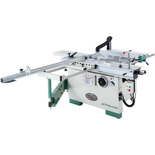

Sliding table saws save time and are a pure joy to work with, but they can also take up a lot of room. What to do if you're pressed for shop space? Check out the compact G0820 12" Sliding Table Saw, measuring in at 118" x 90"! This slider will allow you to crosscut sheets up to 63" x 106-1/4" and rip panels as wide as 33". And don't let the smaller size fool you; this 7-1/2 HP workhorse has all of the user-friendly features you'd expect from an industrial-duty sliding table saw, like a scoring blade that eliminates tear-out, a miter fence with adjustable flip-stops, dust ports above and below the blade, riving knife, a standard rip fence, and a clamping hold-down system for the sliding table. For production ripping and crosscutting, every shop needs a sliding table saw, and the G0820 just might be the perfect fit!
  • Motor: 7-1/2 HP, 220V/440V*, prewired for 220V, 3-phase
  • Full load amps: 20A/10A
  • Main blade size: 12"
  • Main blade arbor: 1"
  • Main blade tilt: 0–45°
  • Main blade speed: 4000 RPM
  • Depth of cut at 90°: 3-5/16"
  • Depth of cut at 45°: 2-3/8"
  • Scoring blade size: 4-3/4" (120mm)
  • Scoring blade arbor: 20mm
  • Scoring blade tilt: 0–45°
  • Scoring blade speed: 8000 RPM
  • Sliding table size: 63" x 12-1/4"
  • Maximum rip capacity: 33"
  • Length of crosscut: 63"
  • Max capacity of crosscut fence: 68-1/2"
  • Maximum sheet capacity: 63" x 101-1/2"
  • Main Table Dimensions: 35-1/4" x 21-1/2"
  • Footprint: 45" x 35"
  • Approximate shipping weight: 996 lbs.
*Prewired for 220V. If you require 440V operation, Grizzly must convert your machine at the time of purchase to maintain the machine's warranty. A $250 non-refundable fee will be added to your order. Please allow extra shipping time for the conversion. If you need more information, please contact technical service.
