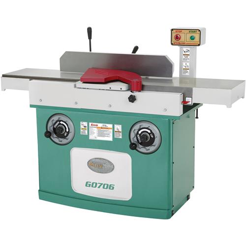

You asked for it - you got it! Based on numerous requests from customers who wanted a 12" Jointer, but did not have the room in their shops for the longer beds, we came up with an exclusive 60" bed jointer to fit the bill. While still long enough to handle all your edging and facing needs, you'll really appreciate its space saving footprint. We've even added a flat serpentine belt and pulleys for quiet and efficient power transfer. Throw in a powerful 3 horsepower motor, heavy-duty cast iron construction and a spiral cutterhead & you've got a jointer that will out-perform its bigger cousins.
Features:
  • Parallelogram table adjustment
  • Fence is center mounted, positive stops at 45°, 90° & 135°
  • Heavy-duty steel base
  • Independently adjustable, handwheel precision table movement
  • Poly V-belt and pulleys
  • Stress-relieved infeed and outfeed tables
  • Pedestal-mounted ON/OFF switch
  • Cast aluminum guard
  • Integral 5" dust port
  • Motor: 3 HP, 220V, single-phase, 15A, TEFC capacitor start induction
  • Cast iron table size: 13" x 60"
  • Fence: 5-3/8" x 31-1/4"
  • Cutterhead: 4 row spiral with 60 indexable solid carbide inserts
  • Cutterhead diameter: 3-3/4"
  • Cutterhead speed: 4950 RPM
  • Insert size: 14mm x 14mm x 2mm
  • Bevel jointing: 45°, 90°, and 135°
  • Maximum depth of cut: 1/8"
  • Maximum width of cut: 12"
  • Switch: magnetic with thermal overload protector
  • Power transfer: Serpentine belt drive
  • Bearings: Shielded and lubricated
  • Floor to table height: 31-1/2"
  • Overall length: 60"
  • Overall width: 30-3/4"
  • Overall height: 43-1/4"
  • Footprint: 39-3/8" x 22-3/8"
  • Approximate shipping weight: 834 lbs.
