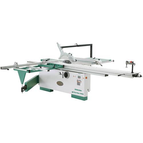

This 12" Slider has all the features of its 14" bigger brother, the G0493, including the amazing ability to cross-cut or rip-cut up to 126", meaning this saw has the largest cutting capacity out of any 12" Sliding Table Saw that we carry! But that's not all that makes this saw great--it also has an independent scoring blade motor that allows the main motor to focus all power on cuts up to 3-5/16" thick. A see-through, fully-enclosed blade guard is also standard equipment, so you don't have to sacrifice optimal dust collection for safety. Of course, just like the big boys, this saw also features a riving knife that moves up and down with the blade, a micro-adjustable rip fence for traditional table saw cuts, and an extruded aluminum, extendable crosscutting fence with two very solid flip stops. Best of all, this saw has the capabilities and options only found in much more expensive machines.
