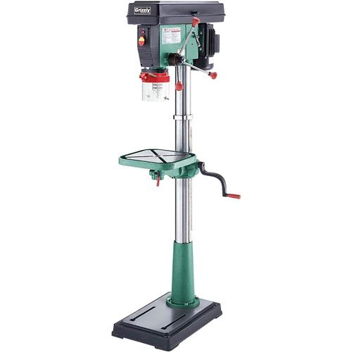

    If you use your drill press commercially and need power and capacity, this is one drill press you should look at seriously. Note the 4-3/4" spindle travel!
    • Motor: 1 HP, single-phase, 110V/220V, prewired 110V
    • Overall height: 70"
    • Swing: 17"
    • Spindle travel: 4-3/4"
    • Number of speeds: 12 (210, 310, 400, 440, 630, 670, 1260, 1430, 1650, 2050, 2350, 3300 RPM)
    • Quill flange/collar dia: 3.623"
    • Drill chuck: 1/64"-5/8"
    • Spindle taper: MT #3
    • Drilling capacity: 1" steel
    • Table T-slot size: 5/8" wide
    • Precision-ground cast iron table
    • Table size: 13-5/8" x 13-5/8".
    • Table swing: 360 degrees
    • Table tilts: 90 degrees in both directions
    • Footprint: 27-1/2" x 19-1/4"
    • Approx. shipping weight: 283 lbs.
    • Includes built-in light (bulb not included)
