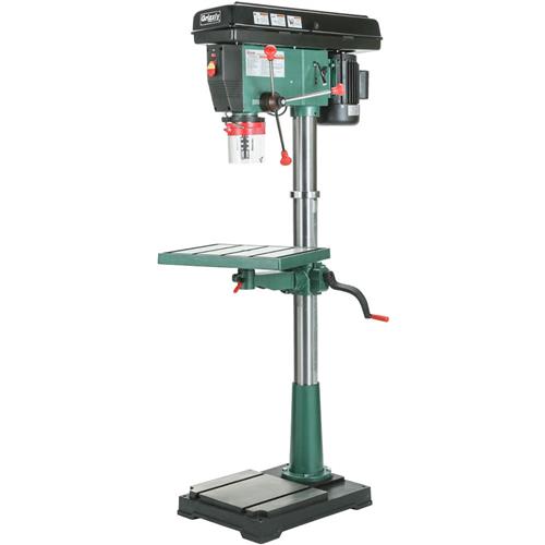

When this drill press arrives at your door, you're gonna say "Holy Moley!". The MT #4 spindle taper, 1-1/2" HP motor and precision-ground T-slotted table will handle just about any drilling job. Includes built-in light (bulb not included).
  • Motor: 1-1/2 HP, 110V/220V, single-phase, prewired 110V
  • Swing: 20"
  • Drill chuck: 1/64"–5/8"
  • Drilling capacity: 1-1/4" steel
  • Spindle taper: MT #4
  • Spindle travel: 4-3/4"
  • Number of speeds: 12 (210, 310, 400, 440, 630, 670, 1260, 1430, 1650, 2050, 2350, 3300 RPM)
  • Quill flange/collar dia: 3.642"
  • Precision-ground cast iron table
  • Table T-slot size: 5/8" wide, 4-1/4" on centers
  • Table size: 18-3/4" x 16-3/4"
  • Footprint: 23" x 18"
  • Overall height: 70-3/4"
  • Approx. shipping weight: 331 lbs.
