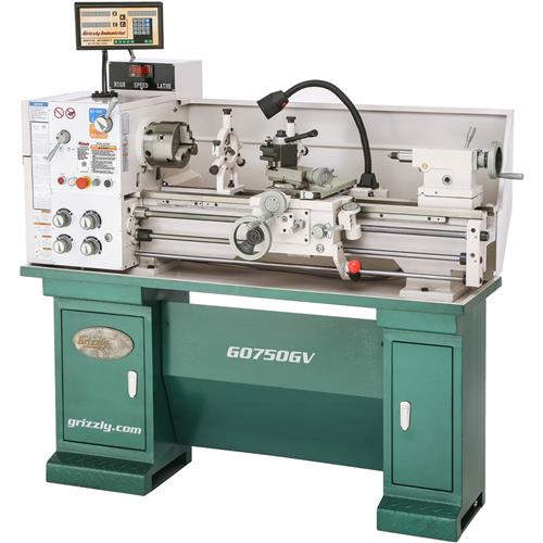

Whether crowning a barrel end or matching exact chamber specifications, rest assured that you'll be able to dial in the perfect spindle speed with the G0750GV 12" x 36" EVS Gunsmithing Lathe. With all of the same great features of its sister lathe, the G0750G, this version also offers electronic variable-speed spindle control with a large digital tachometer and a built-in 2-axis DRO for precision control.
Features:
  • Removable bed gap
  • Spindle switch on carriage
  • LED worklight
  • Steady and follow rests with roller bearing supports
  • Outboard spindle support spider
  • Cast iron stand with extended base
  • Cast aluminum end-gear cover
  • 1/2" tailstock square-drive lock-down to use torque wrench for precise positioning
  • Cuts RL and LH threads
  • Swing over bed: 12"
  • Swing over gap: 17"
  • Swing over cross slide: 7"
  • Distance between centers: 36"
  • Bed width: 7-1/4"
  • Spindle bore: 1.57" (40mm)
  • Spindle nose taper: MT #5
  • Spindle nose: D1-5
  • Spindle length: 17"
  • Spindle length with 4-jaw chuck: 21-1/4"
  • Cuts LH threads
  • Cross slide travel: 5-5/16"
  • Compound travel: 3-1/4"
  • Tailstock barrel taper: MT #3
  • Tailstock barrel travel: 3-3/4"
  • Motor: 2 HP, 220V, 3-phase, 8.5 Amps, 60 Hz, 1725 RPM
  • Number of speeds: Variable
  • Range of speeds: 60-2200 RPM
  • Height with stand: 56"
  • Length with stand: 67"
  • Width of stand: 29-1/2"
  • Approximate shipping weight: 1236 lbs.
