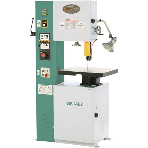

This versatile bandsaw allows intricate cutting of aluminum or brass to tool steel. Features a blade welding station which includes a cutter, welder, annealer and a grinder. Ideal for making inside cuts and quick repairs.
Features:
  • Variable speeds range from 105–2100 FPM
  • Blade welding station includes cutter, welder, annealer and grinder
  • Left, right table tilting control
  • Upper and lower blade guides
  • Integrated chip pan
  • Work light
  • Wheel brush
  • Main motor: 2 HP, 220V, 3-phase, 1725 RPM with single-phase inverter
  • Grinder motor: 1/8 HP, 220V, single-phase
  • Power source: 220V, single-phase, 60 Hz
  • Maximum cutting height: 10-1/4"
  • Throat capacity: 15-3/4"
  • Blade length range: 133"–136"
  • Included blade size: 134" x 3/8" x 10 TPI (similar to Grizzly model G8816)
  • Blade size range: 1/8"–3/4"
  • Blade speed: Variable, 105–2100 FPM
  • Electric welder: 4.2 KVA
  • Table tilt: 45° right, 15° left
  • Floor to table height: 38"
  • Table size: 21-11/16" x 23-5/8"
  • Overall dimensions: 36-3/8" W x 71-7/8" H x 19-1/8" D
  • Approximate shipping weight: 694 lbs.
