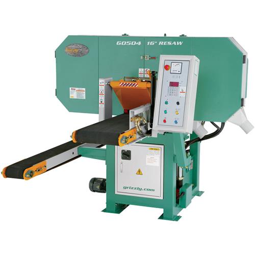

This is the Horizontal Bandsaw that is taking over the resaw market! Topping the scale at over 4300 lbs, the Grizzly Model G0504 Resaw Bandsaw is the master of all resaw machines! Built to the exacting standards demanded by today's professionals, the Model G0504 features state-of-the-art systems such as digital controls, precision hydraulic blade tensioning with gauge, and a variable-speed hydraulic conveyor drive system. A 30 HP, 3-phase motor rounds out this machine for unsurpassed power to handle your biggest resaw operations.
"Dock" delivery or flatbed truck arrangements are necessary for this item.
Features:
  • Digital height control for accurate blade positioning (enter the thickness you want and press a button)
  • Variable-speed hydraulically driven feed and return conveyor
  • Powered saw elevation
  • Hydraulic blade tensioning with gauge
  • Dual 4" dust port
  • Adjustable ceramic blade guides
  • Massive steel frame construction
  • Steel conveyor table
  • Steel fence with rollers
  • 4" cast-iron pressure rollers with polyurethane tires
  • Hinged wheel cover
  • Bi-fold doors
  • Simple and quick blade changes
  • Main motor: 30 HP, 220V/440V*, 3-phase, prewired 220V
  • Elevation motor: 1/2 HP, 220V/440V*, 3-phase, prewired 220V
  • Full-load amps: 74.2A at 220V, 42.1A at 440V
  • Hydraulic pressure: 1000 PSI
  • Maximum cutting capacity: 10" x 16"
  • Distance from blade to conveyor table: 1/4" - 10"
  • Saw wheel diameter: 28" x 7/8"
  • Saw blade size: 180" x 1" x 0.063"
  • Saw blade speed: 7300 FPM
  • Conveyor belt sizes: 15-1/4" x 215-3/4" long and 7-1/4" x 215-3/4" long
  • Variable feed speed: 0 - 61 FPM
  • Conveyor table: 16" wide x 106" long
  • Floor to table height: 40"
  • Overall size: 85" W x 83-1/2" H x 108"D
  • Approx. Shipping Weight: 4325 lbs.
    *440V operation requires purchasing additional components and installation by our technicians. Please call customer service at (570) 546-9663 for more information.
