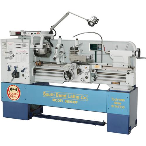

Special engineering with strict control over tolerances, materials and finish produced a machine that lives up to the South Bend®; name with spectacular results! The most seasoned machinist will appreciate the electronic variable speed control, 6" of quill travel in the tailstock, feed direction control on the apron, extra wide saddle for maximum rigidity and adjustable feed rod clutch with stop collar. A universal gear box eliminates gear changes for any pitch the machine can produce! Maintenance is also a snap with a one-shot lubricator on the apron, pressurized lube to the spindle and pull-out chip tray. Beautiful South Bend®; light gray and two-tone blue color scheme. Feature for feature, you won't find a lathe of this quality anywhere else!
  • Fagor DRO
  • Swing over bed: 16.14"
  • Distance between centers: 40"
  • Swing over cross slide: 10.375"
  • Swing over gap: 22.95"
  • Width of bed: 10.24"
  • Spindle nose to gap: 6.5"
  • Cross slide travel: 9.25"
  • Compound slide travel: 5.1"
  • Spindle nose: D1-6 CAMLOCK
  • Spindle bore: 2.0625"
  • Spindle taper: MT #6
  • Spindle speeds: variable 20 - 2500 RPM
  • Tailstock taper: MT #4
  • Quill travel: 6"
  • Tailstock quill diameter: 2.047"
  • Inch thread range: 2 to 72 tpi (45 changes)
  • Metric thread range: 0.2 to 14 mm(39 changes)
  • Modular pitches: 0.3 to 3.5 MP (18 changes)
  • Diametral pitches: 8 to 44 DP(21 changes)
  • Longitudinal feed range: 0.002 to 0.067 IPR
  • Cross feed range: 0.001 to 0.034 IPR
  • Number of inch threads: 45
  • Number of longitudinal feeds: 17
  • Number of cross feeds: 17
  • Coolant motor size: 1/8 HP
  • Spindle motor size: 7.5 HP
  • SB1037 voltage: 220V, 3-phase, 60 cycle
  • SB1038 voltage: 440V, 3-phase, 60 cycle
  • Machine footprint: 19-1/2" x 88"
  • Working envelope: 55" x 110"
  • Approximate shipping weight: 3132 lbs
    Standard Equipment:
  • Adjustable feed rod clutch
  • Allen Bradley electrical components
  • Meehanite casting, signature South Bend®3 V-bed
  • 9" 3 jaw scroll chuck w/ D1-6 back plate
  • 10" 4 jaw ind. chuck D1-6
  • 12" faceplate D1-6
  • Safety chuck guard with microswitch shut-off
  • Steady rest with roller tips
  • Follow rest
  • 4 way tool post
  • Halogen lamp
  • Complete coolant system
  • Micrometer carriage stop
  • Spindle sleeve MT6/MT4
  • Two MT#4 dead centers
  • Threading dial indicator
  • Leveling pads - 8 pcs
  • NSK or NTN Japanese spindle bearings
  • Full length splash guard
  • Front removable sliding chip tray
  • Tool set and box
  • Operation manual and parts list
  • Yaskawa G7A25P5 inverter
