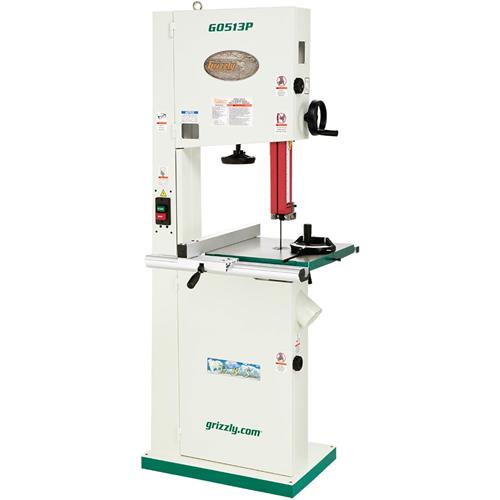

Great features, big cutting capacities and now available in Polor Bear white, this 17" Heavy-Duty Bandsaw will continue to be a popular choice for bandsaw customers. With its 2 HP motor and 12-1/8" cutting height, it has the power and capability to resaw all day long. Yet, with the variety of blade widths available, this saw will contour cut without even a pause. Check out all of these features and specifications:
  • Motor: 2 HP, 110V/220V, single-phase, 60 Hz, TEFC capacitor start induction
  • Prewired voltage: 220V
  • Amps: 20A at 110V, 10A at 220V
  • RPM: 1725
  • Power transfer: Belt drive
  • Precision-ground cast iron table
  • Table size: 17" x 17" x 1-1/2" thick
  • Table tilt: 10° left, 45° right
  • Floor to table height: 37-1/2"
  • Cutting capacity/throat: 16-1/4" left of blade
  • Maximum cutting height: 12-1/8"
  • Blade length: 131-1/2"
  • Blade width range: 1/8" – 1" wide
  • Blade speeds: 1700 and 3500 FPM
  • Wheels: Fully-balanced cast-aluminum with polyurethane tires
  • Wheel covers: Pre-formed steel
  • Blade guides: Euro-style roller disc with full enclosure protection
  • Bearings: sealed and permanently lubricated
  • Overall size: 73" H x 32" W x 32" D
  • Footprint: 27" L x 17-3/4" D x 2-1/2" H
  • Approximate shipping weight: 346 lbs.
  • Deluxe extruded-aluminum fence
  • Includes miter gauge
  • Two 4" dust ports
  • Quick-change blade release/tensioner
  • Blade tension indicator
  • Micro-adjustable geared table
  • Blade height scale measurement
  • Blade tracking window
  • Includes 1/2" 6-TPI hook blade
