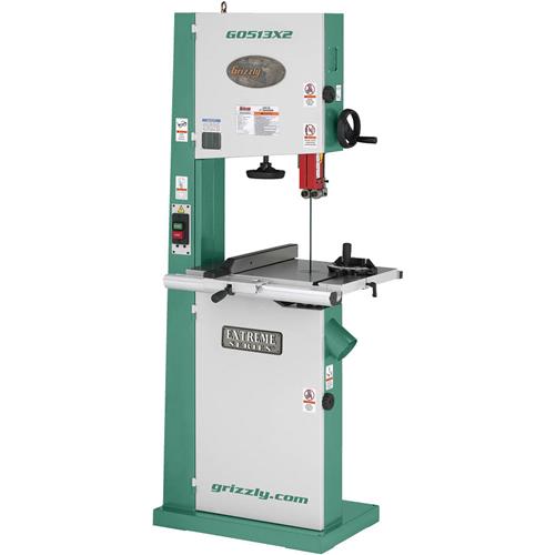

    Grizzly is proud to offer this full-featured Extreme 17" Heavy-duty Bandsaw with cast iron wheels. The 2 HP motor powers through wood with a maximum cutting capacity of 12-1/8" height and a 16-1/4" throat is plenty for most applications. Features like the deluxe fence, extra wide cast-iron table, heavy-duty miter gauge, dual 4" dust ports, micro-adjusting geared table, and double ball-bearing blade guides are usually found on machines costing much more. And, the ISO 9001 factory designation assures high quality standards.
    • Motor: 2 HP, 110V/220V, single-phase, TEFC capacitor start induction, 60 Hz, 1725 RPM, pre-wired to 220V
    • Amps: 20A at 110V, 10A at 220V
    • Power transfer: Belt drive
    • Table size: 23-5/8" x 17-1/4" x 1-1/2" thick
    • Table tilt: 5° left, 45° right
    • Floor to table height: 37-1/2"
    • Cutting capacity/throat: 16-1/4" left of blade
    • Maximum cutting height: 12"
    • Blade size: 131-1/2" long
    • Blade width range: 1/8" – 1" wide
    • 2 blade speeds: 1700 and 3500 FPM
    • Wheel covers: Pre-formed steel
    • Blade guides: Ball-bearing with full enclosure protection
    • Bearings: Sealed and permanently lubricated
    • Overall size: 73" H x 32" W x 32" D
    • Footprint: 27" L x 17-3/4" W x 2-1/2" H
    • Approximate shipping weight: 418 lbs.
    • Deluxe cast iron fence with extruded aluminum re-saw fence
    • Includes miter gauge
    • Two 4" dust ports
    • Quick-change blade release/tensioner
    • Blade tension indicator
    • Micro-adjusting geared table
    • Computer balanced cast-iron wheels with polyurethane tires
    • Blade height scale measurement
    • Blade tracking window
    • Includes 1/2" 6-TPI hook blade
    • Cast-iron table trunnions
    • Rack and pinion upper blade guide height adjustment
