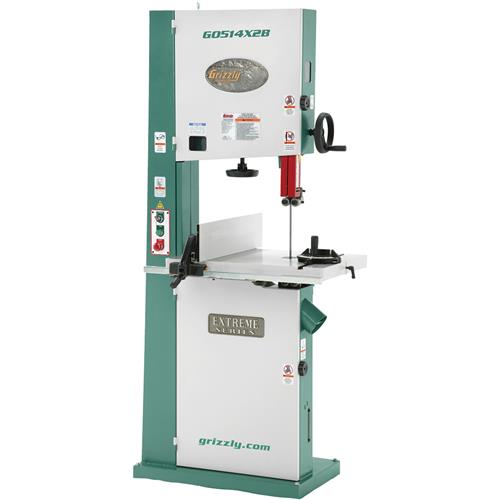

We took our rock-solid G0514X 19" Heavy-duty Extreme Series® Bandsaw, added a few more features and came up with a new line of ultimate 19" Bandsaws. This saw features an lightning-fast electronic motor brake, a cast iron table trunnion, rack and pinion table tilt control with extra table support, and an innovative resaw fence. The electronic motor brake stops the blade in approximately 3 seconds—all with the simple push of a switch. Now that's fast and easy!
We have a limited supply of stock that is CSA certified. Please call 1-800-523-4777 for more details, as these are available upon request only. Shipping exceptions may apply.
  • Blade tension indicator
  • Micro adjusting geared table tilting mechanism
  • Height scale measurement
  • Fence with scale and magnifying window
  • Deluxe cast iron fence with extruded aluminum re-saw fence
  • Miter gauge
  • 4" dust port x 2
  • Table tilt 5° left, 45° right
  • Quick change blade release/tensioning
  • Rack and pinion upper guide adjustment
  • Rack and pinion table tilt mechanism
  • Motor brake
  • Cast iron trunnion
  • Includes 3/4" blade
  • Motor: 3 HP, 220V, single-phase, or 3 HP, 220V/440V*, 3-phase, TEFC, 60 Hz
  • RPM: 1725
  • Precision ground cast iron table
  • Table size: 26-3/4" x 19" x 1-1/2" thick
  • Floor to table height: 37-1/2"
  • Cutting capacity/throat: 18-1/4"
  • Maximum cutting height: 12"
  • Blade size: 143" long
  • Blade sizes available: 1/8" - 1-1/4"
  • 2 Blade speeds: 1700, 3500 FPM
  • Wheels: fully balanced cast iron with polyurethane tires
  • Wheel covers: pre-formed, hinged steel
  • Blade guides: dual ball bearing with full enclosure protection
  • Bearings: sealed and permanently lubricated
  • Overall size: 76" H x 36" W x 32" D
  • Approximate shipping weight: 512 lbs.
