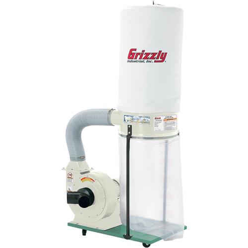

    This is the same machine as our G1029Z2, but with the hugely popular Polar Bear color scheme. It features a 2.5 micron top bag to capture the fine dust particles that normally end up all over your shop. We buy these machines in huge quantities—with no middleman—so we can pass the savings on to you.CSA certified meeting CSA C22.2 No 243-M91 and UL 1017-4th standards!
  • Motor: 2HP, 240V, single-phase, 3450 RPM
  • Motor amp draw: 9 Amps
  • Air suction capacity: 1550 CFM
  • Static pressure: 11"
  • 6" inlet has removable "Y" fitting with two 4" openings
  • Impeller: 12-3/4" balanced cast aluminum
  • Bag capacity: 5.7 cubic feet
  • Standard bag filtration: 2.5 micron
  • Portable base size: 21-1/4" x 33-1/2"
  • Bag size (dia. x depth): 19-1/2" x 33"
  • Powder coated paint
  • Height with bags inflated: 78"
  • Approximate shipping weight: 122 lbs.
  • W1049 2 Stage Cyclone Separator FREE with purchase of G1029Z2P
    Optional Replacement Bags: G5556 Upper Bag; T20543 Lower Bag
