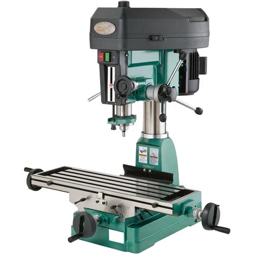

This Mill/Drill has long been accepted in the market as a machine that can handle the work of machines costing thousands of dollars more. We go one step further and offer you this improved model with a super-large table. The table can also be used manually. It comes standard with 3" carbide fly cutter, angle vise and 1/2" drill chuck.
Specifications
  • Motor: 2 HP, 110V/220V, 18A/9A, single-phase, prewired 110V
  • Spindle taper: R-8
  • Spindle travel: 5"
  • Swing: 15-7/8"
  • Max. distance spindle to table: 18"
  • Column size: 4-1/2"
  • Collars calibrated: 0.001"
  • T-Slots: 4 @ 2-1/16" centers, 5/8" wide
  • Table size: 9-1/2" x 32"
  • Table travel (longitudinal): 23-1/2"
  • Table travel (cross): 7"
  • Drilling capacity: 1-1/4"
  • Number of speeds: 12
  • Range of speeds: 150, 225, 255, 350, 400, 500, 850, 1200, 1500, 1600, 2300, 3000 RPM
  • Approximate shipping weight: 680 lbs.
Features:
  • Exclusive fine downfeed is graduated in 0.001" and is engaged by clutch-type mechanism
  • Heavy-duty, 12-speed tapered roller bearing spindle
  • Push-button switch with thermal overload protection
  • Top-quality workmanship throughout
Show More...
