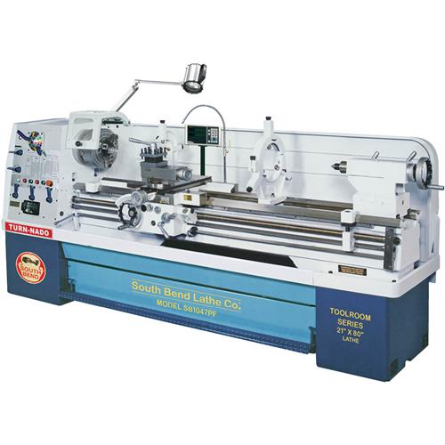

South Bend® quality is built into every one of these fantastic gearhead lathes! Features include universal QC gearbox, extra long saddle for stability, pull out chip pan, and of course, a full compliment of standard equipment that includes 3 & 4-jaw chucks, steady & follow rests, micrometer carriage stop and a lot more. Just check out the specs below and you'll agree, these lathes will be a handsome addition in any busy shop.
These South Bend gearhead lathes are supplied with an adjustable feed rod clutch and stop collar on the feed rod. This is a great safety feature when working close to the chuck. Set the stop collar so the saddle and tool post are positioned at a safe distance from the chuck and tighten the lock screw. Adjust the feed rod clutch to a low setting. If the carriage comes into contact with the collar, the clutch slips, saving your machine from a serious crash.
  • Swing over bed: 20.98"
  • Distance between centers: 80"
  • Swing over cross slide: 14.01"
  • Swing over gap: 31.10"
  • Cross slide travel: 11"
  • Compound travel: 5.39"
  • Carriage travel: 79"
  • Spindle bore: 3.149"
  • Spindle taper: MT #7
  • Spindle speeds: (16), 20-1600 RPM
  • Tailstock taper: MT #5
  • Tailstock travel: 6.5"
  • Tailstock barrel diameter: 3"
  • Inch threads: (38) 2 to 72 TPI
  • Metric threads: (40) 0.4 to 14 mm
  • Modular pitches: (18) 0.3 to 3.5 MP
  • Diametral pitches: (21) 8 to 44 DP
  • Longitudinal feed range: 0.0015" to 0.04"
  • Cross feed range: 0.00075" to 0.02"
  • Spindle motor: 15 HP, TEFC induction
  • Voltage/Amps: 440V, 3-Phase
  • Coolant motor: 1/8 HP, TEFC induction
  • Approximate shipping weight: 6020 lbs.
    Standard Equipment:
  • Fagor DRO
  • 12" 3-Jaw Scroll Chuck (Bolt on Jaws)
  • 14" D1-8 4-Jaw Independent Chuck
  • Chuck Safety Guard with Limit Switch
  • 14" Faceplate
  • Steady Rest
  • Follow Rest
  • Halogen Work Light
  • Coolant System
  • Dead Center MT #5, 2 pcs
  • Spindle Center Sleeve MT #7 - MT #5
  • Micrometer Carriage Stop
  • 4-Way Tool Post
  • Tool Set & Box
  • Level Pads 8 pcs.
    Features:
  • Three V-way Bed
  • FAG German Bearings
  • Full Length Splash Guard
  • Operation Manual
  • Allen Bradley Controls
  • Handwheel Safety Guard
  • Sliding Chip Tray
  • Wood Crate
