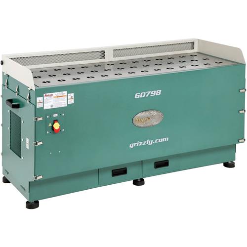

Stop fine metal particulate in its tracks with our new 22" x 62" Metalworking Downdraft Table. The all-steel construction offers a solid platform for any grinding task, and our dual 3/4 HP motors and squirrel-cage impellers ensure you have the suction needed to catch larger particulate. The four built-in, 200-micron filters are designed to accommodate an array of metal sanding, grinding, soldering, and polishing applications, and cleanup is a breeze with two large, easily-removable swarf trays. With a table load capacity of up to 440 lbs., and particulate suction of up to 3700 CFM, this downdraft table is sure to bring a higher-degree of cleanliness and safety to your metalworking shop.
  • Motors: 3/4 HP, 110V, single-phase, TENV capacitor-start induction (x2)
  • Amps: 6A (x2)
  • Table surface area: 21-1/2" x 61-1/2"
  • Floor to table height: 29-1/2"
  • Table load capacity: 440 lbs.
  • Airflow rating: 3700 CFM
  • Inlet hole diameter: 8"
  • Outlet size: 10" x 8"
  • Impeller size: 9-1/2" x 7" squirrel cage (x2)
  • Number of filters: 4
  • Filter size: 20" x 16" x 1"
  • Filter micron: 200
  • Footprint size: 21" x 62"
  • Overall size: 65" L x 33-1/2" H x 24" D
  • Approximate shipping weight: 349 lbs.
Features:
  • Designed to accommodate metal sanding, grinding, soldering, and polishing applications
  • Two easy to clean swarf trays
  • Dual 9-1/2" x 7" squirrel cage fans
  • Durable powder-coated finish
  • Quiet operation
  • 1/8" thick steel table inserts
  • Adjustable, vibration-dampening rubber feet
  • Paddle safety switch with removable key
  • 110V power requirement
