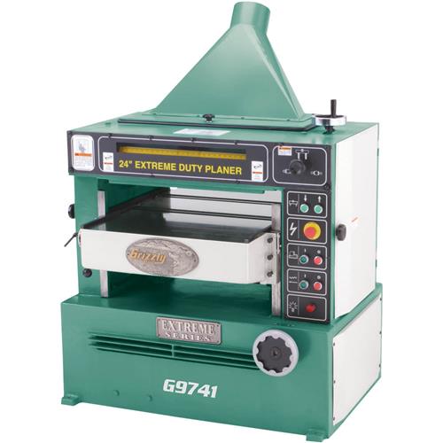

This is the "big daddy" in our line of extreme-duty planers! This machine has all the features of its little brother, like the power up/down control for the table and a variable speed feed. The bed rollers on this machine are also power driven and adjustable for height when rough-cut lumber is milled. Segmented chip breakers, four knife cutterhead and feed rate of 20-40 feet per minute means you can get the best possible finish. Check out the specs and features below, this machine will hold up to the most strenuous production runs.
Specifications
  • Maximum cutting width: 24"
  • Maximum cutting height: 10-1/2"
  • Maximum depth of cut: 5/16"
  • Minimum stock thickness: 1/4"
  • Minimum stock length: 10-1/2"
  • Cutterhead diameter: 4-5/8"
  • Knives: 4 high speed steel - 24-1/8" x 1-3/16" x 1/8"
  • Table size: 24" x 35-1/2"
  • Cutterhead: 5000 R.P.M.
  • Rate of feed per minute: 20-40 F.P.M.
  • Number of cuts per inch: 41.6 - 83.3
  • Number of cuts per minute: 20,000
  • Cutterhead motor: 10 H.P., 220/440V, 3 phase
  • Feed motor: 1 HP
  • Table lift motor: 1/2 HP
  • Cutterhead power transfer: Belt drive
  • Motor bearings: Shielded and lubricated ball bearings
  • Overall size: 42-3/8"W x 36"D
  • Crate size: 45-1/2"H x 48"W x 40"D
  • Shipping weight approx. 1935 lbs.
Features:
  • Precision-ground cast iron table
  • Power feed rollers are steel, segmented infeed and polished outfeed
  • Cutterhead is one piece machine shaft with 4 knife slots and shielded ball bearings
  • Micro adjustment of table height
  • Segmented chip breaker
  • Variable feed rate
  • 5" dust port
  • Convenient control panel
