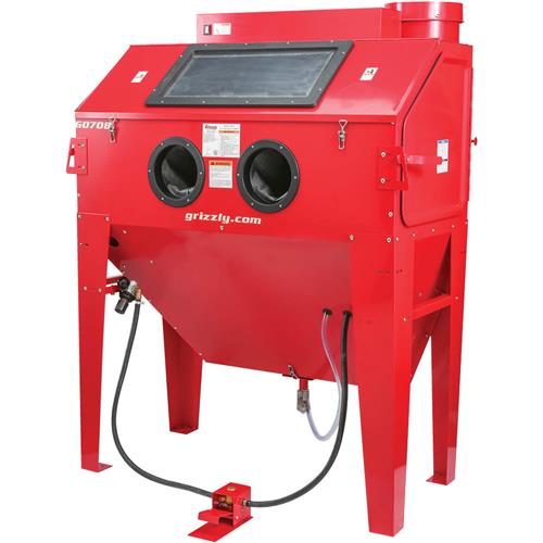

G0708 Professional Sandblasting Cabinet
A real time saver featuring large side loading capabilities.
The G0708 Sandblast Cabinet is designed for high-use media blasting operations where air flow up to 16 CFM and air pressure up to 120 PSI can be used.
Air pressure is fully adjustable with an air pressure regulator and the media output can be adjusted with the media flow valve.
Sandblasting operations through a hand-held blast gun are controlled by a foot valve and most operations can be carried out with all types of blasting media.
An internal set of fluorescent work lamps provide illumination during blasting operations and a built-in dust collector maintains blasting environment visibility.
The cabinet is equipped with front and side loading doors for ease of workpiece loading and unloading.
Media is quickly unloaded through the hopper dump port door, and reloaded through one of the doors.
The G0708 manual was written by our U.S.-based Technical Documentation Department and is packed with useful information.
The complete and easy-to-read manual makes it easier to assemble and maintain your sandblaster.
