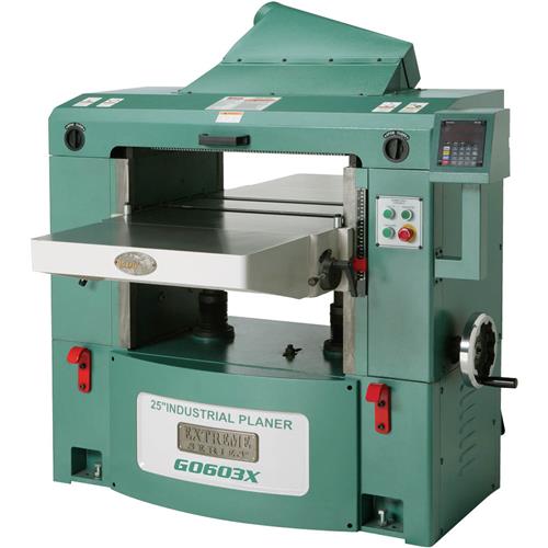

Our new G0603X has an incredible 15 HP motor to make quick work of those big planing jobs. And with this unique spiral cutterhead, with its 15° rotated inserts for smooth shearing cuts, you can say good-bye to tear-out while having an ultra quiet machine and a smoother finish. We’ve even added digital controls to allow you to simply enter the thickness of the board you want or the amount you want to remove, which saves time and reduces waste. All controls are conveniently located. And because it’s a Grizzly Extreme Series® you can be assured of years of trouble-free service.
Features:
  • Segmented chip breaker
  • 5" dust exhaust hood
  • Micro adjustable table height
  • Infeed roller is segmented steel
  • Outfeed roller is finely finished steel
  • Digitally controlled table elevation for extreme accuracy
  • Adjustable bed rollers
  • Easy access cutterhead
  • 3-Speed (20,25,30) Feed Rate
  • Inch/metric readout
  • Table height adjustment buttons
  • Emergency stop button
  • Cutterhead motor: 15 HP, 220V/440V, 3-phase, 37/18.5 amps
  • Precision-ground cast iron table
  • Table size: 25" x 57"
  • Maximum cutting width: 25"
  • Maximum cutting height: 9"
  • Maximum cutting depth: 1/4"
  • Minimum stock length: 10"
  • Feed rate: 20, 25 & 30 FPM
  • Cutterhead: Spiral
  • Cutterhead speed: 4900 RPM
  • Power transfer: Triple V-belt
  • Overall size with extension wings: 60-1/4"H x 57-3/8"W x 54-3/8"D
  • Approximate shipping weight: 2054 lbs.
