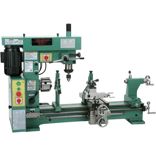

Need a larger combo machine? One with an awesome 31" between centers and 16-1/2" swing? Then the G9729 is the answer. With great features like a magnetic controller and a forward / reverse switch, hardened and ground bedways, two motors for extra power and a 4-way turret tool post makes this a real do-it-all machine. Cuts inch and metric threads with ease and includes a built-in milling table with T-slots, a steady rest and a follow rest. Convenient window allows easy verification of drill spindle speeds. An incredible machine at an unbeatable price!
Features:
  • Forward / reverse switch
  • Built-in milling table with T-slots
  • Two separate motors
  • Power longitudinal feed
  • Power cross feed
  • Magnetic switch
  • Four-position turret tool post
  • Steady and follow rest
  • Tailstock offsets 1/2"
  • Threading dial
  • Swing over bed: 16-1/2"
  • Swing over cross slide: 11-1/2"
  • Distance between centers: 31"
  • Spindle: 4-bolt intrinsic
  • Spindle nose taper: MT #4
  • Drawbar: 3/8" x 16 TPI
  • Spindle bore: 1-1/8"
  • Tailstock barrel taper: MT #3
  • Tailstock travel: 2-1/2"
  • Cross slide travel: 3-3/4"
  • Cross-slide mill table T-slots: 7/16" T-slots, spaced 3.54" (90mm) apart on centers
  • Top slide travel: 2-1/2"
  • Spindle to work table: 12"
  • Spindle travel (drill): 4-5/16"
  • Spindle taper (drill): MT #3
  • Number of speeds: 7 lathe / 16 mill/drill
  • Lathe speed range: 175-1425 RPM
  • Mill/drill speed range: 120-1500 RPM
  • Range of threads (inches): 4-120 TPI
  • Range of threads (metric): 0.75-6.0mm
  • Motor size (single phase 110V): 3/4 H.P.
  • Approximate shipping weight: 692 lbs.
    Standard Accessories:
  • 5" 3-jaw chuck
  • 1/2" drill chuck
  • MT #3 chuck arbor 3/8" x 16 TPI
  • 2 dead centers
  • Change gears
  • Steady rest
  • Follow rest
  • 9" faceplate
