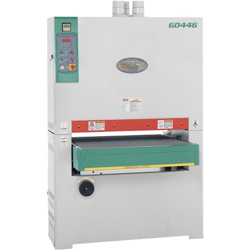

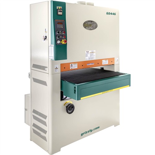

We sell more wide-belt sanders than just about any company in the USA! Filling in the gap between the popular 25" and 43" wide-belt sanders, our 37" Wide-Belt Sanders offer professional sanding results, unmatched accuracy, and unbeatable value. State-of-the-art digital controls, a micro-adjustable graphite/felt platen and three super efficient dust collection ports are just a few features that make these sanders a joy to use. We have the largest selection for these sanders and if you are looking for the best that money can buy, Grizzly Wide-Belt Sanders have been designed and priced just for you!
  • Type: Platen
  • Sanding motor HP: 15 HP
  • Sanding motor voltage: 220/440V
  • Sanding motor phase: 3-phase
  • Sanding motor amps: 36/18A
  • Conveyor motor HP: 1 HP
  • Conveyor motor amps: 3.4/1.7A
  • Table lift motor HP: 1/4 HP
  • Table lift motor amps: 1.2/0.6A
  • Footprint: 19 3/8" x 51 1/2"
  • Maximum board width: 36 1/2"
  • Maximum board thickness: 6"
  • Minimum board length: 9"
  • Minimum board thickness: 1/8"
  • Front drum surface speed: 2600 FPM
  • Conveyor speed: 15-49 FPM
  • Sanding belt size: 37"W x 75"
  • Overall width: 56 1/2"W
  • Overall height: 77 1/2"
  • Overall depth: 52"D
  • Approx. shipping weight: 2755 lbs.
Features:
  • Built in air filter/lubricator
  • Independent motor control
  • Pneumatic belt tracking and tensioning
  • Amp meter for load measurement
  • Safety shut-off bar
  • Digital readout and control panel
  • (3) 4" dust ports
  • Steel cabinet
  • Rubber infeed drum
  • Steel outfeed drum
  • Rubber pressure drums
  • Micro-adjustable graphite/felt platen
  • Made in an ISO 9001 Factory!
