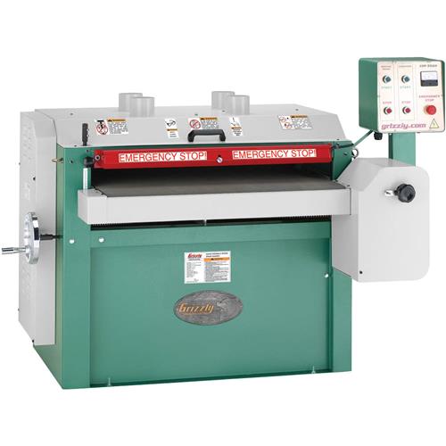

Sand stock up to 36-1/2" wide and 4" thick with variable speed feed control and the economy of spiral-wrapped 6" wide sandpaper rolls. Built for production environments, these Drum Sanders feature industrial-quality conveyor belts and dual 6" sanding drums. Includes a 4-port dust scoop to maximize dust collection, easy access to sanding drums, emergency stop for safety, solid steel construction, independent motor control, amp load meter, and massive power with a 10 HP, single-phase motor. With the variable-speed control on the conveyor, you can dial in the perfect finish you need for each job. CSA certified meeting CSA C22.2 #105-1953 and UL 987-8 standards!
Features:
  • Variable speed conveyor
  • Industrial rubber conveyor belt (similar to wide belt sander belts)
  • Control panel with amp load meter
  • State-of-the-art computer balanced drums
  • Hinged hood for easy drum access
  • External micro adjustment on outfeed drum
  • Gas springs for top cover
  • Sanding drum motor: 10 HP, 240V, single-phase, TEFC, 1725 RPM
  • Conveyor motor: 1/3 HP
  • Maximum board width: 36-1/2"
  • Maximum board thickness: 4"
  • Minimum board length: 9"
  • Minimum board thickness: 1/16"
  • Surface speed of drums: 2800 FPM
  • Conveyor feed rate: Variable, 6 - 18 FPM
  • Sanding drums: 2, steel/rubber
  • Drum diameter: 6"
  • Dust ports: 4, 4"
  • Sandpaper size: 6" x 138"
  • Overall size: 49"H x 68"W x 50-1/2"D
  • Approximate shipping weight: 1406 lbs.
