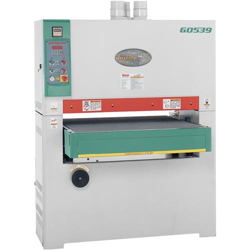

We sell more wide-belt sanders than just about any company in the USA! Filling in the gap between the popular 25" and 43" wide-belt sanders, the G0539 37" Wide-Belt Sander offers professional sanding results, unmatched accuracy, and unbeatable value. State-of-the-art digital controls, a micro-adjustable graphite/felt platen and three super efficient dust collection ports are just a few features that make this sander a joy to use. If you are looking for the best that money can buy, Grizzly Wide-Belt Sanders have been designed and priced just for you!
  • Sanding motor: 15 HP, 220/440V*, 3-phase, 36/18 Amp, 1725 RPM, 60 Hz cycle, triple V-belt drive
  • Conveyor motor: 1/2 HP, 220/440V*,3-phase, 3.4/1.7 Amp, 60 Hz cycle, variable speed belt/gearbox
  • Table elevation motor: 1/4 HP, 220/440V*, 3-phase, 0.8/0.4 Amp, 1725 RPM, 60 Hz cycle, V-belt power transfer
  • Surface speed of drums: 2,600 FPM
  • Conveyor feed rate: Variable, 15-49 FPM
  • Maximum board dimensions: 36-1/2" wide x 6" thick
  • Air requirements: 70 PSI
  • Overall dimensions: 53" x 49-1/2" x 69-1/2"
  • Approximate shipping weight: 1781 lbs.
    Features:
  • Built in air filter/lubricator
  • Independent motor control
  • Pneumatic belt tracking and tensioning
  • Amp meter for load measurement
  • Safety shut-off bar
  • Digital readout and control panel
  • Three 4" dust ports
  • Steel cabinet
  • Rubber infeed drum
  • Steel outfeed drum
  • Rubber pressure drums
  • CSA certified meeting CSA C22.2 #105-1953 and UL 987 Seventh Edition standards.
