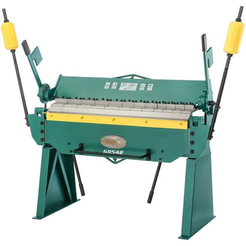

Need to do some heavy-duty bending? This puppy will set an angle in 12 gauge mild steel up to 135°. And it's a brute! It weighs over 1200 lbs. and is equipped with evenly-hardened precision fingers to ensure maximum life and durability. Check out these features:
  • Material capacity: 12ga. @ half width, 14 ga. @ full width
  • Brake angle: 0° to 135°
  • Box fingers: (1) 25" finger, (3) 4" fingers, and (4) 3" fingers
  • Max height of pan/box sides: 6"
  • Approximate shipping wt.: 1271 lbs.
