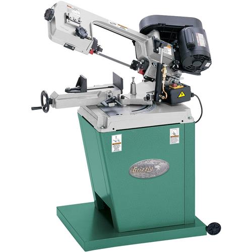

This is one of the best saws on the market for the small or large shop. It features a 5" round and 5" x 6" rectangular capacity. But what really sets this apart from other saws of this size is the head swivel giving a maximum angle of cut of 60 degrees! Remember how much trouble it is to change a vise backing jaw only to get a 45 degree cut? Not with this guy. The easy-to-adjust head has stops in all the right places. And because the vise backing jaw is rigid on this saw, it is taller, giving it the ability to support the workpiece better. And of course, the machine comes with all the features you'd expect from Grizzly like hydraulic down feed control, easy access wheels for quick blade changes and the right blade speeds to do the job.
  • Max. capacity rectangular @ 0 degrees: 5" x 6"
  • Max. capacity circular @ 0 degrees: 5"
  • Max. capacity rectangular @ ±45 degrees: 2-15/16" x 3-3/4"
  • Max. capacity circular @ ±45 degrees: 3-3/4"
  • Max. capacity rectangular @ +60 degrees: 2-3/16" x 1-3/4"
  • Max. capacity circular @ +60 degrees: 1-3/4"
  • Blade speeds: 80, 120, 200 FPM
  • Blade size: 64-1/2" x 1/2"
  • Motor: 1/2 HP, 110V/220V, prewired 110V, single-phase, 60Hz, 1725 RPM
  • Amps: 8.8/4.4
  • Drive: V-belt
  • Transmission: sealed worm gear
  • Overall height: horizontal 42-1/2"; vertical 54-3/4"
  • Height floor-to-table: 29"
  • Overall width: 23-3/8"
  • Overall length: 39"
  • Overall bed: 19-1/4" x 13-1/2" x 3"
  • Footprint: 26-1/2" x 20-1/2"
  • Angular cuts: -45 degrees to +60 degrees
  • Blade size: 1/2" x 64-1/2"
  • Included blade size: 64-1/2" x 1/2" x 15 TPI (similar to Grizzly model G5108)
  • All ball bearing drive wheel and blade guides
  • Shipping weight approx.: 168 lbs.
