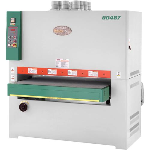

In these days of high labor costs, the more you can do with less labor, the more competitive you can be. Rarely can a machine claim to cut your sanding time in half! Our Double Head Wide-Belt Sanders feature dual heads enabling them to sand to finer grits in a single pass! The first belt runs on a single drum and the rear belt runs on a platen system which allows you to adjust the sanding depth. If you are still sanding through 2 grit levels using a single head wide-belt sander you are not being the most efficient.
We have a limited supply of stock that is CSA certified. Please call 1-800-523-4777 for more details, as these are available upon request only. Shipping exceptions may apply.
Features:
  • Steel cabinet
  • Hard rubber infeed drum, adjustable platen on rear drums
  • Rubber pressure rollers
  • Adjustable graphite platen
  • Digital encoder depth control
  • Amp/load meter
  • Disc brake for emergency stops
  • Variable speed
  • (5) 4" dust ports
  • With digital readout & auto positioning!
  • Made in an ISO 9001 Factory!
  • Sanding motor HP: 30 HP, TEFC
  • Sanding motor voltage: 220/440V
  • Sanding motor phase: 3-phase
  • Sanding motor amps: 72/36A
  • Conveyor motor HP: 2 HP, TEFC
  • Conveyor motor amps: 6.5/3.3A
  • Table lift motor HP: 1/4 HP, TEFC
  • Table lift motor amps: 1.2/0.6A
  • Footprint: 68" x 31"
  • Maximum board width: 51"
  • Maximum board thickness: 6"
  • Minimum board length: 11"
  • Minimum board thickness: 3/16"
  • Front drum surface speed: 3543 FPM
  • Rear drum surface speed: 2565 FPM
  • Conveyor speed: 14-60 FPM
  • Sanding belt size: 51" x 75"
  • Overall width: 71"W
  • Overall height: 79"H
  • Overall depth: 59-1/2"D
  • Approx. shipping weight: 3880 lbs.
