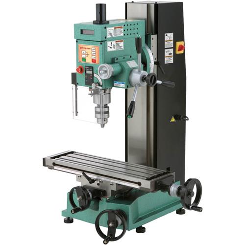

Upgrade to this mill/drill and have all of the great features as listed above and add a tilting head, a multifunction digital scale on the quill, a quick reversing tapping feature, pushbutton speed control and digital speed display. With this machine you can quickly tap one hole or dozens of holes! Press the button, start the tap and when the thread is completed, push another button and the spindle quickly reverses, withdrawing the tap from the hole. And there won't be any question about proper spindle speed! Run the RPM up or down to best suit your tooling/material and be confident that you'll have fewer worn or broken tools.
Features:
  • Dovetail column with handwheel
  • graduated in .0005"
  • Over 14" of headstock movement
  • Dovetail column
  • Digital spindle scale reads metric or
  • inches, zero set, on/off
  • Head tilts 90°
  • Push button variable speed
  • Digital speed display
  • Reversing buttons on the spider handles for tapping
  • Coolant trough
  • Front mounted fine feed knob
  • Push button motor control for forward, reverse, tapping and off
  • Front mounted E-stop button
  • See-through chip guard
  • Includes: 5/8" drill chuck & arbor, 2 T-nuts, 2 open end combo wrenches, 4 Allen® wrenches, extra drive belt and 4 leveling feet
  • Motor 1 HP, 110V, single-phase, universal
  • Spindle taper R-8
  • Spindle travel 2-3/4"
  • Swing 18"
  • Max. distance spindle to table 14-3/4"
  • Collars calibrated .001"
  • T-Slots 3 @ 1-11/16" centers, 3/8" studs
  • Table size 6-1/4" x 21-5/8"
  • Table travel (longitudinal) 15-7/8"
  • Table travel (cross) 5-3/4"
  • Headstock travel 14-7/8"
  • Drilling capacity 1"
  • Quill diameter: 2.347"
  • Variable speed 100-1750 RPM
  • Approximate shipping weight 436 lbs.
