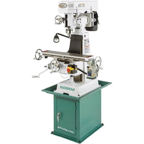

This Vertical Mills is a precision-made machine that is far more than just a step above a mill/drill. It features a tilting head, a knee, satin-finished dials, 9 speeds, and so much more. The power feeder provides smoother finishes and easy operation. Very competitively priced, too - you won't find a better deal!
  • Motor: 1.5 HP, 110V/220V, prewired 110V, 17.8A/8.6A, single-phase, TEFC
  • Spindle taper: R-8
  • Spindle travel: 3"
  • Swing: 10-1/2"
  • Max. distance spindle-to-table: 11"
  • T-Slots: 3 @ 11-1/16" centers, 1/2" wide
  • Table size: 6-1/8" x 26"
  • Table travel (longitudinal): 14-1/4"
  • Table travel (cross): 6"
  • Max. drilling capacity for cast iron: 1"
  • Max. drilling capacity for steel: 3/4"
  • Head tilt: 45° left & right
  • Ram swiveling angle: 45° left & right
  • Number of speeds: 9
  • Range of speeds: 230–2520 RPM
  • Overall dimensions: 45" W x 68" H x 41" D
  • Approximate shipping weight: 914 lbs.
Features:
  • Built-in LED worklight
  • Milling head micro-feed and adjustable depth stop
  • Lockable quill
  • Chuck guard
  • One-shot lubrication
  • Tapered roller spindle bearing
  • Precision-ground dovetail vertical and cross ways
  • Toolbox with service tools
  • Oil gun
  • 1-13mm drill chuck with arbor
  • 7/16"-20 drawbar
  • Two T-Slot bolts with nuts and washer
