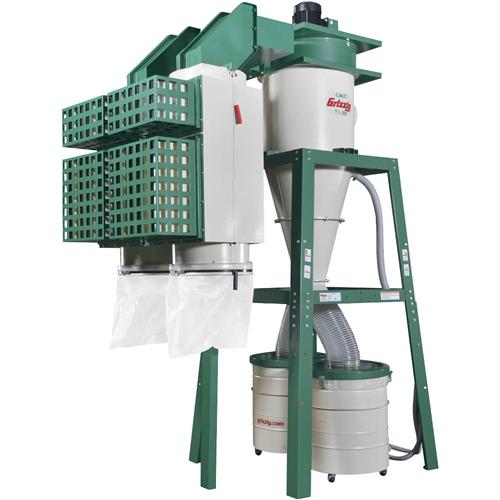

The same unit as our G0637, but pre-equipped with the upgraded dual-filtration HEPA filter system! Features a primary filter efficiency of 99.9% at 0.2-2 microns, and a secondary HEPA filter efficiency of 99.97% at 0.3 microns in size.
We've taken our extremely successful line of Cyclone Dust Collectors a couple of steps further by adding this 7-1/2 HP monster to our selection. With dual filters, 3468 CFM of airflow capacity, and 14.7" maximum static pressure, this cyclone is ideally suited for mid- to large-sized shops with multiple dust-producing machines running at the same time. An innovative air exhaust muffler keeps the noise level down—without reducing efficiency.
CSA certified meeting CAN/CSA C22.2 #243-10 and ANSI/UL 1017-8 standards!
  • Motor: TEFC Class "F", 7-1/2 HP, 220V/440V*, 3-phase, 25A/12.5A
  • Intake hole size: 10"
  • Filter surface area: 261 sq. ft
  • Impeller: 18" steel radial fin
  • Airflow capacity: 3468 CFM @ 4.3" SP
  • Maximum static pressure (inches of water): 14.7"
  • Sound level: 78-80 dB
  • Primary filter: 99.9% at 0.2-2 microns
  • Secondary filter: HEPA rated 99.97% at 0.3 microns
  • Collection drums: Steel, 55 gallon x 2
  • Overall dimensions: 96-1/4" L x 52-1/2" W x 139-3/8" H
  • Stand: 13 gauge steel
  • Cyclone body: 16 gauge steel
  • Blower housing: 11 gauge steel
  • Approx. shipping weight: 1139 lbs.
Features:
  • Ramped inlet maximizes dust flow into the collection drums
  • Steel collection drums have casters for easy dust disposal
  • Remote controlled magnetic switch
  • Class "F" motor
  • Dual pleated filters with cleaning brushes maximize air flow
  • Standard equipment mufflers reduce noise level without reducing air flow
  • 14.73" static pressure for greater duct design flexibility
  • Includes stand
