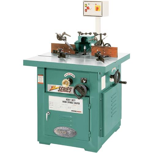

If you need moulding profiles in hardwoods that you can't find at your local millwork supplier, we think you'll find our new 7-1/2 HP Tilting Spindle Shaper worthy of your consideration. Built to withstand the rigors of industrial production, this impressive shaper will literally cut more profiles than you can shake a stick at. The unique tilting spindle will add even more variety and utility to your shaping operations and the conveniently located controls and adjustments make it a safe and easy machine to use and enjoy.
  • Motor: 7-1/2 HP, 220V/440V*, 3-phase
  • Cast iron table and fence assembly
  • Table size: 28" x 35-1/2"
  • Table counterbore: 7" x 5/8" deep
  • Spindle travel: 3-1/4"
  • Spindle tilt: 45°
  • Spindle sizes: 3/4", 1" and 1-1/4"
  • Spindle speeds: 3600, 5100, 8000 and 10,000 RPM
  • Spindle capacity under nut: 5-1/8" (1-1/4" spindle)
  • Maximum cutter diameter: 5-7/8"
  • Welded steel cabinet
  • Tilting spindle allows for infinite profile possibilities with your existing shaper cutters
  • Independent, micro adjustment fence
  • Forward/reversing switch
  • 4" dust port
  • Sturdy hold-downs and cast iron miter gauge standard
  • Overall dimensions: 35-1/2" wide x 43" high x 39" deep (to top of switch)
  • Approximate shipping weight: 710 lbs.
    *Prewired for 220V. If you require 440V operation, Grizzly must convert your machine at the time of purchase to maintain the machine’s warranty. A $250 nonrefundable fee will be added to your order. Please allow extra shipping time for the conversion. If you need more information, please contact technical service.
