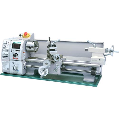

This 8" x 16" Variable-Speed Lathe is perfect for a sturdy workbench or as a stand-alone unit when mounted on the T26599 Optional Stand. Features variable-speed spindle with high/low speed ranges, convenient quick-lock tailstock, reverse feed for cutting left-hand threads, and a great selection of included standard equipment.
  • Swing over: bed 8-1/4", cross slide 4-5/8"
  • Distance between centers: 15-3/4"
  • Spindle: bore 0.787" (20mm), taper MT#3
  • Motor: 600W (3/4 HP), 110V, DC, 10A
  • Spindle speed ranges: Low 50–1000, High 100–2000 RPM
  • Travel: compound rest 2-1/8", cross slide 3"
  • Tailstock: quill travel 2", taper MT#2
  • Feed speeds: (3) 0.0037"–0.0071"/rev
  • Inch threads: (15) 9–44 TPI
  • Metric threads: (12) 0.4–3.0mm
  • Footprint: 31-1/2" x 10-1/2"
  • Overall size: 36" W x 16" D x 14" H
  • Approx. shipping weight: 166 lbs.
Standard Equipment:
  • 4" 3-Jaw and 4-jaw chucks
  • 6-3/4" Faceplate
  • Steady rest & follow rest
  • 4-Way turret tool post (3/8" max tool size)
  • MT#2 & MT#3 dead centers
