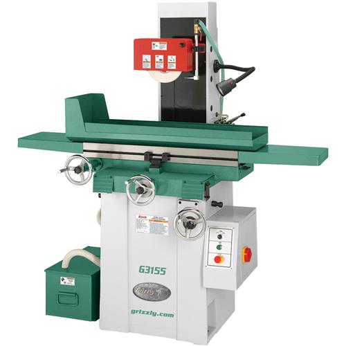

This is the big brother for the G3104 surface grinder, but with more capacity. Heavy castings, smooth operation and dependable precision are built into this well-made unit. Check out the specs below and you will see this is an incredible value for a machine of this quality.
Features:
  • Flood coolant system
  • Column dial
  • Cross feed dial
  • Cast iron cabinet
  • One shot lubrication
  • Power indicator lights
  • Work light
  • 7-7/8" x 15-3/4" magnetic chuck
  • Stone balancing kit
  • Table surface: 8" x 19-3/4"
  • Longitudinal travel: 23-1/8"
  • Cross travel: 9-1/8"
  • Maximum distance table to wheel: 13-7/8"
  • T-slot and size: 1/2" stud, 7/8" head
  • Grinding wheel: 8" D x 1-1/4" B x 3/4" W
  • Height: 64"
  • Width: 43"
  • Depth: 66"
  • Column size: 9-1/4" x 12-3/4"
  • Spindle diameter: 1-1/4"
  • Spindle speed: 3450 RPM
  • Cast iron construction
  • Motor: 2 H.P., TEFC, three phase 220V
  • Shipping weight approx.: 1720 lbs.
